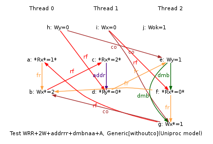

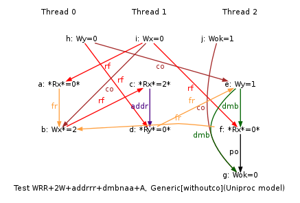

Test WRR+2W+addrrr+dmbnaa+A
Executions for behaviour: "0:R0=0 ; 1:R0=2 ; 1:R2=0 ; 2:R1=0 ; ok=0 ; x=2"
Executions for behaviour: "0:R0=1 ; 1:R0=2 ; 1:R2=0 ; 2:R1=0 ; ok=1 ; x=2"

Observed
    0:R0=0; 1:R0=2; 1:R2=0; 2:R1=0; ok=0; x=2;
and 0:R0=1; 1:R0=2; 1:R2=0; 2:R1=0; ok=1; x=2;
