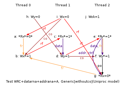

Test WRC+datarna+addrana+A
Executions for behaviour: "0:R0=0 ; 1:R0=1 ; 2:R0=1 ; 2:R2=0 ; ok=1 ; x=1 ; y=1"
ARM WRC+datarna+addrana+A
"RfeAR DpDatadWRNa RfeNaA DpAddrdRANa FreNaA"
Cycle=RfeNaA DpAddrdRANa FreNaA RfeAR DpDatadWRNa
Prefetch=1:x=F,1:y=W,2:y=F,2:x=T
Com=Rf Rf Fr
Orig=RfeAR DpDatadWRNa RfeNaA DpAddrdRANa FreNaA
{ ok=1;
%x0=x; %ok0=ok;
%x1=x; %y1=y;
%y2=y; %x2=x; %ok2=ok;
 P0                  | P1             | P2                 ;
 MOV %T3,#1          | LDREX R0,[%x1] | LDREX R0,[%y2]     ;
 LDREX R0,[%x0]      | EOR R1,R0,R0   | STREX %T2,R0,[%y2] ;
 STREX %T2,%T3,[%x0] | ADD R1,R1,#1   | CMP %T2,#0         ;
 CMP %T2,#0          | STR R1,[%y1]   | BNE Fail2          ;
 BNE Fail0           |                | EOR R1,R0,R0       ;
 B Exit0             |                | LDR R2,[R1,%x2]    ;
 Fail0:              |                | B Exit2            ;
 MOV R1,#0           |                | Fail2:             ;
 STR R1,[%ok0]       |                | MOV R3,#0          ;
 Exit0:              |                | STR R3,[%ok2]      ;
                     |                | Exit2:             ;
Observed
    0:R0=0; 1:R0=1; 2:R0=1; 2:R2=0; ok=1; x=1; y=1;
