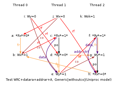

Test WRC+datara+addrar+A
Executions for behaviour: "0:R0=0 ; 1:R0=1 ; 1:R2=0 ; 2:R0=1 ; 2:R2=0 ; ok=1 ; x=1 ; y=1"
ARM WRC+datara+addrar+A
"RfeAR DpDatadWRA RfeAA DpAddrdRAR FreRA"
Cycle=RfeAA DpAddrdRAR FreRA RfeAR DpDatadWRA
Prefetch=1:x=F,1:y=W,2:y=F,2:x=T
Com=Rf Rf Fr
Orig=RfeAR DpDatadWRA RfeAA DpAddrdRAR FreRA
{ ok=1;
%x0=x; %ok0=ok;
%x1=x; %y1=y; %ok1=ok;
%y2=y; %x2=x; %ok2=ok;
 P0                  | P1                 | P2                 ;
 MOV %T3,#1          | LDREX R0,[%x1]     | LDREX R0,[%y2]     ;
 LDREX R0,[%x0]      | EOR R1,R0,R0       | STREX %T2,R0,[%y2] ;
 STREX %T2,%T3,[%x0] | ADD R1,R1,#1       | CMP %T2,#0         ;
 CMP %T2,#0          | LDREX R2,[%y1]     | BNE Fail2          ;
 BNE Fail0           | STREX %T2,R1,[%y1] | EOR R1,R0,R0       ;
 B Exit0             | CMP %T2,#0         | ADD %T1,R1,%x2     ;
 Fail0:              | BNE Fail1          | LDREX R2,[%T1]     ;
 MOV R1,#0           | B Exit1            | B Exit2            ;
 STR R1,[%ok0]       | Fail1:             | Fail2:             ;
 Exit0:              | MOV R3,#0          | MOV R3,#0          ;
                     | STR R3,[%ok1]      | STR R3,[%ok2]      ;
                     | Exit1:             | Exit2:             ;
    0:R0=0; 1:R0=1; 1:R2=0; 2:R0=1; 2:R2=0; ok=1; x=1; y=1;
