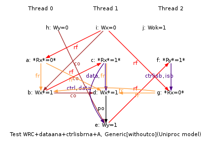

Test WRC+dataana+ctrlisbrna+A
Executions for behaviour: "0:R0=0 ; 1:R0=1 ; 2:R0=1 ; 2:R1=0 ; ok=1 ; x=1"
ARM WRC+dataana+ctrlisbrna+A
"RfeAA DpDatadWANa RfeNaR DpCtrlIsbdRRNa FreNaA"
Cycle=RfeNaR DpCtrlIsbdRRNa FreNaA RfeAA DpDatadWANa
Prefetch=1:x=F,1:y=W,2:y=F,2:x=T
Com=Rf Rf Fr
Orig=RfeAA DpDatadWANa RfeNaR DpCtrlIsbdRRNa FreNaA

 P0                  | P1                 | P2             ;
 MOV %T3,#1          | LDREX R0,[%x1]     | LDREX R0,[%y2] ;
 LDREX R0,[%x0]      | STREX %T2,R0,[%x1] | CMP R0,R0      ;
 STREX %T2,%T3,[%x0] | CMP %T2,#0         | BNE LC00       ;
 CMP %T2,#0          | BNE Fail1          | LC00:          ;
 BNE Fail0           | EOR R1,R0,R0       | ISB            ;
 B Exit0             | ADD R1,R1,#1       | LDR R1,[%x2]   ;
 Fail0:              | STR R1,[%y1]       |                ;
 MOV R1,#0           | B Exit1            |                ;
 STR R1,[%ok0]       | Fail1:             |                ;
 Exit0:              | MOV R2,#0          |                ;
                     | STR R2,[%ok1]      |                ;
                     | Exit1:             |                ;
Observed
    0:R0=0; 1:R0=1; 2:R0=1; 2:R1=0; ok=1; x=1;
