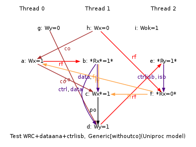

Test WRC+dataana+ctrlisb
Executions for behaviour: "1:R0=1 ; 2:R0=1 ; 2:R1=0 ; ok=1 ; x=1"
ARM WRC+dataana+ctrlisb
"RfeNaA DpDatadWANa Rfe DpCtrlIsbdR Fre"
Cycle=Rfe DpCtrlIsbdR Fre RfeNaA DpDatadWANa
Prefetch=1:x=F,1:y=W,2:y=F,2:x=T
Com=Rf Rf Fr
Orig=RfeNaA DpDatadWANa Rfe DpCtrlIsbdR Fre
{ ok=1;
%x0=x;
%x1=x; %y1=y; %ok1=ok;
%y2=y; %x2=x;
 P0           | P1                 | P2           ;
 MOV R0,#1    | LDREX R0,[%x1]     | LDR R0,[%y2] ;
 STR R0,[%x0] | STREX %T2,R0,[%x1] | CMP R0,R0    ;
              | CMP %T2,#0         | BNE LC00     ;
              | BNE Fail1          | LC00:        ;
              | EOR R1,R0,R0       | ISB          ;
              | ADD R1,R1,#1       | LDR R1,[%x2] ;
              | STR R1,[%y1]       |              ;
              | B Exit1            |              ;
              | Fail1:             |              ;
              | MOV R2,#0          |              ;
              | STR R2,[%ok1]      |              ;
              | Exit1:             |              ;
Observed
    1:R0=1; 2:R0=1; 2:R1=0; ok=1; x=1;
