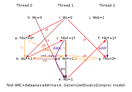

Test WRC+dataana+addrrna+A
Executions for behaviour: "0:R0=0 ; 1:R0=1 ; 2:R0=1 ; 2:R2=0 ; ok=1 ; x=1"
ARM WRC+dataana+addrrna+A
"RfeAA DpDatadWANa RfeNaR DpAddrdRRNa FreNaA"
Cycle=RfeNaR DpAddrdRRNa FreNaA RfeAA DpDatadWANa
Prefetch=1:x=F,1:y=W,2:y=F,2:x=T
Com=Rf Rf Fr
Orig=RfeAA DpDatadWANa RfeNaR DpAddrdRRNa FreNaA
{ ok=1;
%x0=x; %ok0=ok;
%x1=x; %y1=y; %ok1=ok;
%y2=y; %x2=x;
 P0                  | P1                 | P2              ;
 MOV %T3,#1          | LDREX R0,[%x1]     | LDREX R0,[%y2]  ;
 LDREX R0,[%x0]      | STREX %T2,R0,[%x1] | EOR R1,R0,R0    ;
 STREX %T2,%T3,[%x0] | CMP %T2,#0         | LDR R2,[R1,%x2] ;
 CMP %T2,#0          | BNE Fail1          |                 ;
 BNE Fail0           | EOR R1,R0,R0       |                 ;
 B Exit0             | ADD R1,R1,#1       |                 ;
 Fail0:              | STR R1,[%y1]       |                 ;
 MOV R1,#0           | B Exit1            |                 ;
 STR R1,[%ok0]       | Fail1:             |                 ;
 Exit0:              | MOV R2,#0          |                 ;
                     | STR R2,[%ok1]      |                 ;
                     | Exit1:             |                 ;
Observed
    0:R0=0; 1:R0=1; 2:R0=1; 2:R2=0; ok=1; x=1;
