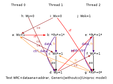

Test WRC+dataana+addrar
Executions for behaviour: "1:R0=1 ; 2:R0=1 ; 2:R2=0 ; ok=1 ; x=1 ; y=1"
ARM WRC+dataana+addrar
"RfeNaA DpDatadWANa RfeNaA DpAddrdRAR FreRNa"
Cycle=RfeNaA DpAddrdRAR FreRNa RfeNaA DpDatadWANa
Prefetch=1:x=F,1:y=W,2:y=F,2:x=T
Com=Rf Rf Fr
Orig=RfeNaA DpDatadWANa RfeNaA DpAddrdRAR FreRNa
{ ok=1;
%x0=x;
%x1=x; %y1=y; %ok1=ok;
%y2=y; %x2=x; %ok2=ok;
 P0           | P1                 | P2                 ;
 MOV R0,#1    | LDREX R0,[%x1]     | LDREX R0,[%y2]     ;
 STR R0,[%x0] | STREX %T2,R0,[%x1] | STREX %T2,R0,[%y2] ;
              | CMP %T2,#0         | CMP %T2,#0         ;
              | BNE Fail1          | BNE Fail2          ;
              | EOR R1,R0,R0       | EOR R1,R0,R0       ;
              | ADD R1,R1,#1       | ADD %T1,R1,%x2     ;
              | STR R1,[%y1]       | LDREX R2,[%T1]     ;
              | B Exit1            | B Exit2            ;
              | Fail1:             | Fail2:             ;
              | MOV R2,#0          | MOV R3,#0          ;
              | STR R2,[%ok1]      | STR R3,[%ok2]      ;
              | Exit1:             | Exit2:             ;
Observed
    1:R0=1; 2:R0=1; 2:R2=0; ok=1; x=1; y=1;
