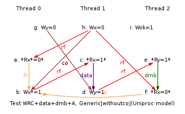

Test WRC+data+dmb+A
Executions for behaviour: "0:R0=0 ; 1:R0=1 ; 2:R0=1 ; 2:R1=0 ; ok=1 ; x=1"
ARM WRC+data+dmb+A
"RfeANa DpDatadW Rfe DMBdRR FreNaA"
Cycle=Rfe DMBdRR FreNaA RfeANa DpDatadW
Prefetch=1:x=F,1:y=W,2:y=F,2:x=T
Com=Rf Rf Fr
Orig=RfeANa DpDatadW Rfe DMBdRR FreNaA

 P0                  | P1           | P2           ;
 MOV %T3,#1          | LDR R0,[%x1] | LDR R0,[%y2] ;
 LDREX R0,[%x0]      | EOR R1,R0,R0 | DMB          ;
 STREX %T2,%T3,[%x0] | ADD R1,R1,#1 | LDR R1,[%x2] ;
 CMP %T2,#0          | STR R1,[%y1] |              ;
 BNE Fail0           |              |              ;
 B Exit0             |              |              ;
 Fail0:              |              |              ;
 MOV R1,#0           |              |              ;
 STR R1,[%ok0]       |              |              ;
 Exit0:              |              |              ;
Observed
    0:R0=0; 1:R0=1; 2:R0=1; 2:R1=0; ok=1; x=1;
