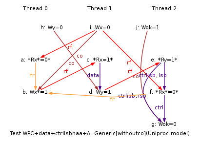

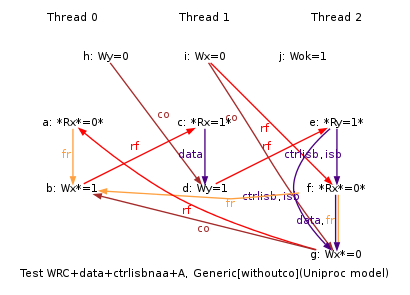

Test WRC+data+ctrlisbnaa+A
Executions for behaviour: "0:R0=0 ; 1:R0=1 ; 2:R0=1 ; 2:R1=0 ; ok=0 ; x=1"
Executions for behaviour: "0:R0=0 ; 1:R0=1 ; 2:R0=1 ; 2:R1=0 ; ok=1 ; x=1"
ARM WRC+data+ctrlisbnaa+A
"RfeANa DpDatadW Rfe DpCtrlIsbdRNaA FreAA"
Cycle=Rfe DpCtrlIsbdRNaA FreAA RfeANa DpDatadW
Prefetch=1:x=F,1:y=W,2:y=F,2:x=T
Com=Rf Rf Fr
Orig=RfeANa DpDatadW Rfe DpCtrlIsbdRNaA FreAA
