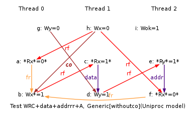

Test WRC+data+addrrr+A
Executions for behaviour: "0:R0=0 ; 1:R0=1 ; 2:R0=1 ; 2:R2=0 ; ok=1 ; x=1"
ARM WRC+data+addrrr+A
"RfeANa DpDatadW RfeNaR DpAddrdRRR FreRA"
Cycle=RfeNaR DpAddrdRRR FreRA RfeANa DpDatadW
Prefetch=1:x=F,1:y=W,2:y=F,2:x=T
Com=Rf Rf Fr
Orig=RfeANa DpDatadW RfeNaR DpAddrdRRR FreRA
{ ok=1;
%x0=x; %ok0=ok;
%x1=x; %y1=y;
%y2=y; %x2=x;
 P0                  | P1           | P2             ;
 MOV %T3,#1          | LDR R0,[%x1] | LDREX R0,[%y2] ;
 LDREX R0,[%x0]      | EOR R1,R0,R0 | EOR R1,R0,R0   ;
 STREX %T2,%T3,[%x0] | ADD R1,R1,#1 | ADD %T1,R1,%x2 ;
 CMP %T2,#0          | STR R1,[%y1] | LDREX R2,[%T1] ;
 BNE Fail0           |              |                ;
 B Exit0             |              |                ;
 Fail0:              |              |                ;
 MOV R1,#0           |              |                ;
 STR R1,[%ok0]       |              |                ;
 Exit0:              |              |                ;
Observed
    0:R0=0; 1:R0=1; 2:R0=1; 2:R2=0; ok=1; x=1;
