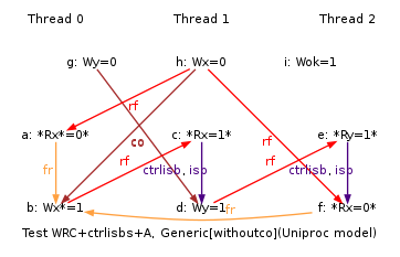

Test WRC+ctrlisbs+A
Executions for behaviour: "0:R0=0 ; 1:R0=1 ; 2:R0=1 ; 2:R1=0 ; ok=1 ; x=1"
ARM WRC+ctrlisbs+A
"RfeANa DpCtrlIsbdW Rfe DpCtrlIsbdR FreNaA"
Cycle=Rfe DpCtrlIsbdR FreNaA RfeANa DpCtrlIsbdW
Prefetch=1:x=F,1:y=W,2:y=F,2:x=T
Com=Rf Rf Fr
Orig=RfeANa DpCtrlIsbdW Rfe DpCtrlIsbdR FreNaA
{ ok=1;
%x0=x; %ok0=ok;
%x1=x; %y1=y;
%y2=y; %x2=x;
 P0                  | P1           | P2           ;
 MOV %T3,#1          | LDR R0,[%x1] | LDR R0,[%y2] ;
 LDREX R0,[%x0]      | CMP R0,R0    | CMP R0,R0    ;
 STREX %T2,%T3,[%x0] | BNE LC00     | BNE LC01     ;
 CMP %T2,#0          | LC00:        | LC01:        ;
 BNE Fail0           | ISB          | ISB          ;
 B Exit0             | MOV R1,#1    | LDR R1,[%x2] ;
 Fail0:              | STR R1,[%y1] |              ;
 MOV R1,#0           |              |              ;
 STR R1,[%ok0]       |              |              ;
 Exit0:              |              |              ;
Observed
    0:R0=0; 1:R0=1; 2:R0=1; 2:R1=0; ok=1; x=1;
