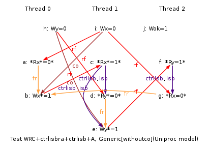

Test WRC+ctrlisbra+ctrlisb+A
Executions for behaviour: "0:R0=0 ; 1:R0=1 ; 1:R1=0 ; 2:R0=1 ; 2:R1=0 ; ok=1 ; x=1 ; y=1"
ARM WRC+ctrlisbra+ctrlisb+A
"RfeAR DpCtrlIsbdWRA RfeANa DpCtrlIsbdR FreNaA"
Cycle=RfeANa DpCtrlIsbdR FreNaA RfeAR DpCtrlIsbdWRA
Prefetch=1:x=F,1:y=W,2:y=F,2:x=T
Com=Rf Rf Fr
Orig=RfeAR DpCtrlIsbdWRA RfeANa DpCtrlIsbdR FreNaA
{ ok=1;
%x0=x; %ok0=ok;
%x1=x; %y1=y; %ok1=ok;
%y2=y; %x2=x;
 P0                  | P1                  | P2           ;
 MOV %T3,#1          | LDREX R0,[%x1]      | LDR R0,[%y2] ;
 LDREX R0,[%x0]      | CMP R0,R0           | CMP R0,R0    ;
 STREX %T2,%T3,[%x0] | BNE LC00            | BNE LC01     ;
 CMP %T2,#0          | LC00:               | LC01:        ;
 BNE Fail0           | ISB                 | ISB          ;
 B Exit0             | MOV %T3,#1          | LDR R1,[%x2] ;
 Fail0:              | LDREX R1,[%y1]      |              ;
 MOV R1,#0           | STREX %T2,%T3,[%y1] |              ;
 STR R1,[%ok0]       | CMP %T2,#0          |              ;
 Exit0:              | BNE Fail1           |              ;
                     | B Exit1             |              ;
                     | Fail1:              |              ;
                     | MOV R2,#0           |              ;
                     | STR R2,[%ok1]       |              ;
                     | Exit1:              |              ;
Observed
    0:R0=0; 1:R0=1; 1:R1=0; 2:R0=1; 2:R1=0; ok=1; x=1; y=1;
