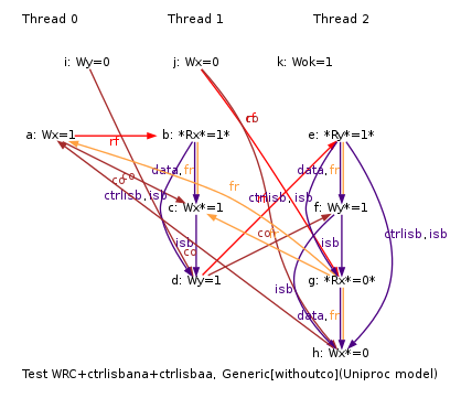

Test WRC+ctrlisbana+ctrlisbaa
Executions for behaviour: "1:R0=1 ; 2:R0=1 ; 2:R1=0 ; ok=1 ; x=1 ; y=1"
ARM WRC+ctrlisbana+ctrlisbaa
"RfeNaA DpCtrlIsbdWANa RfeNaA DpCtrlIsbdRAA FreANa"
Cycle=RfeNaA DpCtrlIsbdWANa RfeNaA DpCtrlIsbdRAA FreANa
Prefetch=1:x=F,1:y=W,2:y=F,2:x=T
Com=Rf Rf Fr
Orig=RfeNaA DpCtrlIsbdWANa RfeNaA DpCtrlIsbdRAA FreANa
{ ok=1;
%x0=x;
%x1=x; %y1=y; %ok1=ok;
%y2=y; %x2=x; %ok2=ok;
 P0           | P1                 | P2                 ;
 MOV R0,#1    | LDREX R0,[%x1]     | LDREX R0,[%y2]     ;
 STR R0,[%x0] | STREX %T2,R0,[%x1] | STREX %T2,R0,[%y2] ;
              | CMP %T2,#0         | CMP %T2,#0         ;
              | BNE Fail1          | BNE Fail2          ;
              | CMP R0,R0          | CMP R0,R0          ;
              | BNE LC00           | BNE LC01           ;
              | LC00:              | LC01:              ;
              | ISB                | ISB                ;
              | MOV R1,#1          | LDREX R1,[%x2]     ;
              | STR R1,[%y1]       | STREX %T2,R1,[%x2] ;
              | B Exit1            | CMP %T2,#0         ;
              | Fail1:             | BNE Fail2          ;
              | MOV R2,#0          | B Exit2            ;
              | STR R2,[%ok1]      | Fail2:             ;
              | Exit1:             | MOV R2,#0          ;
              |                    | STR R2,[%ok2]      ;
              |                    | Exit2:             ;
Observed
    1:R0=1; 2:R0=1; 2:R1=0; ok=1; x=1; y=1;
