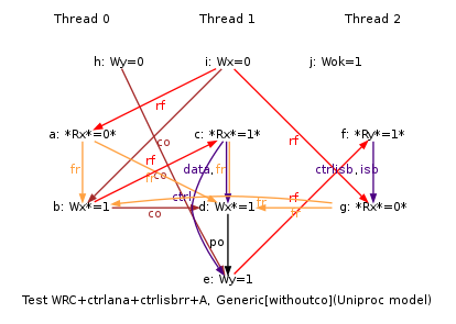

Test WRC+ctrlana+ctrlisbrr+A
Executions for behaviour: "0:R0=0 ; 1:R0=1 ; 2:R0=1 ; 2:R1=0 ; ok=1 ; x=1"
ARM WRC+ctrlana+ctrlisbrr+A
"RfeAA DpCtrldWANa RfeNaR DpCtrlIsbdRRR FreRA"
Cycle=RfeNaR DpCtrlIsbdRRR FreRA RfeAA DpCtrldWANa
Prefetch=1:x=F,1:y=W,2:y=F,2:x=T
Com=Rf Rf Fr
Orig=RfeAA DpCtrldWANa RfeNaR DpCtrlIsbdRRR FreRA

 P0                  | P1                 | P2             ;
 MOV %T3,#1          | LDREX R0,[%x1]     | LDREX R0,[%y2] ;
 LDREX R0,[%x0]      | STREX %T2,R0,[%x1] | CMP R0,R0      ;
 STREX %T2,%T3,[%x0] | CMP %T2,#0         | BNE LC01       ;
 CMP %T2,#0          | BNE Fail1          | LC01:          ;
 BNE Fail0           | CMP R0,R0          | ISB            ;
 B Exit0             | BNE LC00           | LDREX R1,[%x2] ;
 Fail0:              | LC00:              |                ;
 MOV R1,#0           | MOV R1,#1          |                ;
 STR R1,[%ok0]       | STR R1,[%y1]       |                ;
 Exit0:              | B Exit1            |                ;
                     | Fail1:             |                ;
                     | MOV R2,#0          |                ;
                     | STR R2,[%ok1]      |                ;
                     | Exit1:             |                ;
Observed
    0:R0=0; 1:R0=1; 2:R0=1; 2:R1=0; ok=1; x=1;
