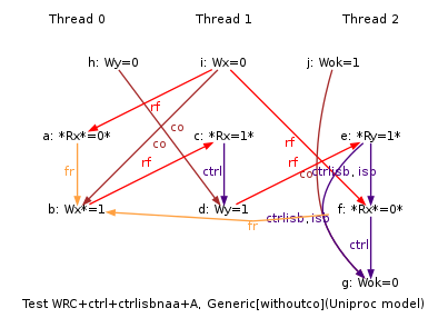

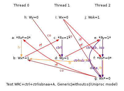

Test WRC+ctrl+ctrlisbnaa+A
Executions for behaviour: "0:R0=0 ; 1:R0=1 ; 2:R0=1 ; 2:R1=0 ; ok=0 ; x=1"
Executions for behaviour: "0:R0=0 ; 1:R0=1 ; 2:R0=1 ; 2:R1=0 ; ok=1 ; x=1"

Observed
    0:R0=0; 1:R0=1; 2:R0=1; 2:R1=0; ok=0; x=1;
and 0:R0=0; 1:R0=1; 2:R0=1; 2:R1=0; ok=1; x=1;
