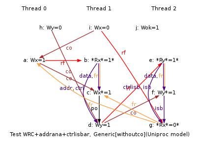

Test WRC+addrana+ctrlisbar
Executions for behaviour: "1:R0=1 ; 2:R0=1 ; 2:R1=0 ; ok=1 ; x=1 ; y=1"
ARM WRC+addrana+ctrlisbar
"RfeNaA DpAddrdWANa RfeNaA DpCtrlIsbdRAR FreRNa"
Cycle=RfeNaA DpAddrdWANa RfeNaA DpCtrlIsbdRAR FreRNa
Prefetch=1:x=F,1:y=W,2:y=F,2:x=T
Com=Rf Rf Fr
Orig=RfeNaA DpAddrdWANa RfeNaA DpCtrlIsbdRAR FreRNa

 P0           | P1                 | P2                 ;
 MOV R0,#1    | LDREX R0,[%x1]     | LDREX R0,[%y2]     ;
 STR R0,[%x0] | STREX %T2,R0,[%x1] | STREX %T2,R0,[%y2] ;
              | CMP %T2,#0         | CMP %T2,#0         ;
              | BNE Fail1          | BNE Fail2          ;
              | EOR R1,R0,R0       | CMP R0,R0          ;
              | MOV R2,#1          | BNE LC00           ;
              | STR R2,[R1,%y1]    | LC00:              ;
              | B Exit1            | ISB                ;
              | Fail1:             | LDREX R1,[%x2]     ;
              | MOV R3,#0          | B Exit2            ;
              | STR R3,[%ok1]      | Fail2:             ;
              | Exit1:             | MOV R2,#0          ;
              |                    | STR R2,[%ok2]      ;
              |                    | Exit2:             ;
Observed
    1:R0=1; 2:R0=1; 2:R1=0; ok=1; x=1; y=1;
