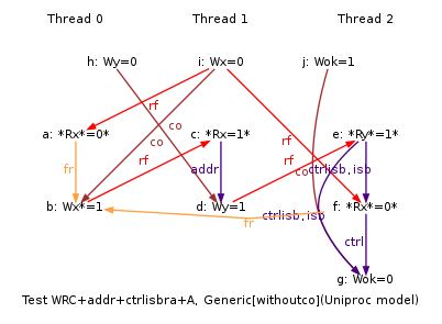

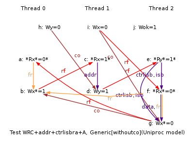

Test WRC+addr+ctrlisbra+A
Executions for behaviour: "0:R0=0 ; 1:R0=1 ; 2:R0=1 ; 2:R1=0 ; ok=0 ; x=1"
Executions for behaviour: "0:R0=0 ; 1:R0=1 ; 2:R0=1 ; 2:R1=0 ; ok=1 ; x=1"
ARM WRC+addr+ctrlisbra+A
"RfeANa DpAddrdW RfeNaR DpCtrlIsbdRRA FreAA"
Cycle=RfeNaR DpCtrlIsbdRRA FreAA RfeANa DpAddrdW
Prefetch=1:x=F,1:y=W,2:y=F,2:x=T
Com=Rf Rf Fr
Orig=RfeANa DpAddrdW RfeNaR DpCtrlIsbdRRA FreAA
