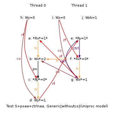

Test S+poaa+ctrlnaa
Executions for behaviour: "0:R0=1 ; 0:R1=0 ; 1:R0=1 ; 1:R1=0 ; ok=1 ; x=2 ; y=1"
ARM S+poaa+ctrlnaa
"PodWWAA RfeANa DpCtrldWNaA WseAA"
Cycle=RfeANa DpCtrldWNaA WseAA PodWWAA
Prefetch=0:x=F,0:y=W,1:y=F,1:x=W
Com=Rf Ws
Orig=PodWWAA RfeANa DpCtrldWNaA WseAA
{ ok=1;
%x0=x; %y0=y; %ok0=ok;
%y1=y; %x1=x; %ok1=ok;
 P0                  | P1                  ;
 MOV %T3,#2          | LDR R0,[%y1]        ;
 LDREX R0,[%x0]      | CMP R0,R0           ;
 STREX %T2,%T3,[%x0] | BNE LC00            ;
 CMP %T2,#0          | LC00:               ;
 BNE Fail0           | MOV %T3,#1          ;
 MOV %T3,#1          | LDREX R1,[%x1]      ;
 LDREX R1,[%y0]      | STREX %T2,%T3,[%x1] ;
 STREX %T2,%T3,[%y0] | CMP %T2,#0          ;
 CMP %T2,#0          | BNE Fail1           ;
 BNE Fail0           | B Exit1             ;
 B Exit0             | Fail1:              ;
 Fail0:              | MOV R2,#0           ;
 MOV R2,#0           | STR R2,[%ok1]       ;
 STR R2,[%ok0]       | Exit1:              ;
 Exit0:              |                     ;
Observed
    0:R0=1; 0:R1=0; 1:R0=1; 1:R1=0; ok=1; x=2; y=1;
