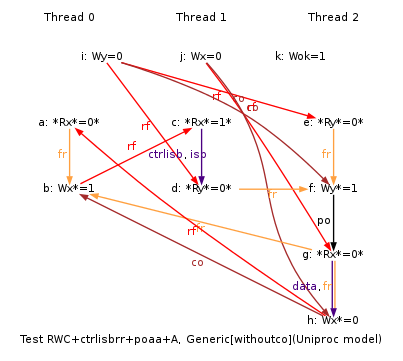

Test RWC+ctrlisbrr+poaa+A
Executions for behaviour: "0:R0=0 ; 1:R0=1 ; 1:R1=0 ; 2:R0=0 ; 2:R1=0 ; ok=1 ; x=1 ; y=1"
ARM RWC+ctrlisbrr+poaa+A
"RfeAR DpCtrlIsbdRRR FreRA PodWRAA FreAA"
Cycle=RfeAR DpCtrlIsbdRRR FreRA PodWRAA FreAA
Prefetch=1:x=F,1:y=T,2:y=F,2:x=T
Com=Rf Fr Fr
Orig=RfeAR DpCtrlIsbdRRR FreRA PodWRAA FreAA
{ ok=1;
%x0=x; %ok0=ok;
%x1=x; %y1=y;
%y2=y; %x2=x; %ok2=ok;
 P0                  | P1             | P2                  ;
 MOV %T3,#1          | LDREX R0,[%x1] | MOV %T3,#1          ;
 LDREX R0,[%x0]      | CMP R0,R0      | LDREX R0,[%y2]      ;
 STREX %T2,%T3,[%x0] | BNE LC00       | STREX %T2,%T3,[%y2] ;
 CMP %T2,#0          | LC00:          | CMP %T2,#0          ;
 BNE Fail0           | ISB            | BNE Fail2           ;
 B Exit0             | LDREX R1,[%y1] | LDREX R1,[%x2]      ;
 Fail0:              |                | STREX %T2,R1,[%x2]  ;
 MOV R1,#0           |                | CMP %T2,#0          ;
 STR R1,[%ok0]       |                | BNE Fail2           ;
 Exit0:              |                | B Exit2             ;
                     |                | Fail2:              ;
                     |                | MOV R2,#0           ;
                     |                | STR R2,[%ok2]       ;
                     |                | Exit2:              ;
Observed
    0:R0=0; 1:R0=1; 1:R1=0; 2:R0=0; 2:R1=0; ok=1; x=1; y=1;
