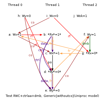

Test RWC+ctrlaa+dmb
Executions for behaviour: "1:R0=1 ; 1:R1=0 ; 2:R1=0 ; ok=1 ; x=1 ; y=1"
ARM RWC+ctrlaa+dmb
"RfeNaA DpCtrldRAA FreANa DMBdWR Fre"
Cycle=RfeNaA DpCtrldRAA FreANa DMBdWR Fre
Prefetch=1:x=F,1:y=T,2:y=F,2:x=T
Com=Rf Fr Fr
Orig=RfeNaA DpCtrldRAA FreANa DMBdWR Fre
{ ok=1;
%x0=x;
%x1=x; %y1=y; %ok1=ok;
%y2=y; %x2=x;
 P0           | P1                 | P2           ;
 MOV R0,#1    | LDREX R0,[%x1]     | MOV R0,#1    ;
 STR R0,[%x0] | STREX %T2,R0,[%x1] | STR R0,[%y2] ;
              | CMP %T2,#0         | DMB          ;
              | BNE Fail1          | LDR R1,[%x2] ;
              | CMP R0,R0          |              ;
              | BNE LC00           |              ;
              | LC00:              |              ;
              | LDREX R1,[%y1]     |              ;
              | STREX %T2,R1,[%y1] |              ;
              | CMP %T2,#0         |              ;
              | BNE Fail1          |              ;
              | B Exit1            |              ;
              | Fail1:             |              ;
              | MOV R2,#0          |              ;
              | STR R2,[%ok1]      |              ;
              | Exit1:             |              ;
Observed
    1:R0=1; 1:R1=0; 2:R1=0; ok=1; x=1; y=1;
