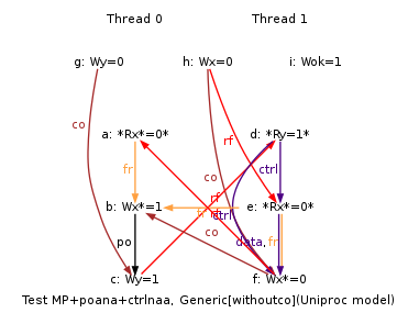

Test MP+poana+ctrlnaa
Executions for behaviour: "0:R0=0 ; 1:R0=1 ; 1:R1=0 ; ok=1 ; x=1"
ARM MP+poana+ctrlnaa
"PodWWANa Rfe DpCtrldRNaA FreAA"
Cycle=Rfe DpCtrldRNaA FreAA PodWWANa
Prefetch=0:x=F,0:y=W,1:y=F,1:x=T
Com=Rf Fr
Orig=PodWWANa Rfe DpCtrldRNaA FreAA

 P0                  | P1                 ;
 MOV %T3,#1          | LDR R0,[%y1]       ;
 LDREX R0,[%x0]      | CMP R0,R0          ;
 STREX %T2,%T3,[%x0] | BNE LC00           ;
 CMP %T2,#0          | LC00:              ;
 BNE Fail0           | LDREX R1,[%x1]     ;
 MOV R1,#1           | STREX %T2,R1,[%x1] ;
 STR R1,[%y0]        | CMP %T2,#0         ;
 B Exit0             | BNE Fail1          ;
 Fail0:              | B Exit1            ;
 MOV R2,#0           | Fail1:             ;
 STR R2,[%ok0]       | MOV R2,#0          ;
 Exit0:              | STR R2,[%ok1]      ;
                     | Exit1:             ;
Observed
    0:R0=0; 1:R0=1; 1:R1=0; ok=1; x=1;
