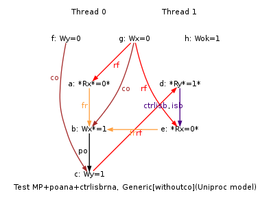

Test MP+poana+ctrlisbrna
Executions for behaviour: "0:R0=0 ; 1:R0=1 ; 1:R1=0 ; ok=1 ; x=1"
ARM MP+poana+ctrlisbrna
"PodWWANa RfeNaR DpCtrlIsbdRRNa FreNaA"
Cycle=RfeNaR DpCtrlIsbdRRNa FreNaA PodWWANa
Prefetch=0:x=F,0:y=W,1:y=F,1:x=T
Com=Rf Fr
Orig=PodWWANa RfeNaR DpCtrlIsbdRRNa FreNaA

 P0                  | P1             ;
 MOV %T3,#1          | LDREX R0,[%y1] ;
 LDREX R0,[%x0]      | CMP R0,R0      ;
 STREX %T2,%T3,[%x0] | BNE LC00       ;
 CMP %T2,#0          | LC00:          ;
 BNE Fail0           | ISB            ;
 MOV R1,#1           | LDR R1,[%x1]   ;
 STR R1,[%y0]        |                ;
 B Exit0             |                ;
 Fail0:              |                ;
 MOV R2,#0           |                ;
 STR R2,[%ok0]       |                ;
 Exit0:              |                ;
Observed
    0:R0=0; 1:R0=1; 1:R1=0; ok=1; x=1;
