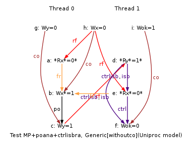

Executions for behaviour: "0:R0=0 ; 1:R0=1 ; 1:R1=0 ; ok=0 ; x=1"

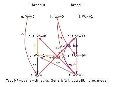

Executions for behaviour: "0:R0=0 ; 1:R0=1 ; 1:R1=0 ; ok=1 ; x=1"
