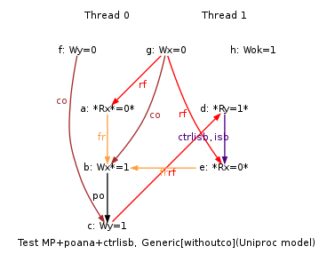

Test MP+poana+ctrlisb
Executions for behaviour: "0:R0=0 ; 1:R0=1 ; 1:R1=0 ; ok=1 ; x=1"
ARM MP+poana+ctrlisb
"PodWWANa Rfe DpCtrlIsbdR FreNaA"
Cycle=Rfe DpCtrlIsbdR FreNaA PodWWANa
Prefetch=0:x=F,0:y=W,1:y=F,1:x=T
Com=Rf Fr
Orig=PodWWANa Rfe DpCtrlIsbdR FreNaA
{ ok=1;
%x0=x; %y0=y; %ok0=ok;
%y1=y; %x1=x;
 P0                  | P1           ;
 MOV %T3,#1          | LDR R0,[%y1] ;
 LDREX R0,[%x0]      | CMP R0,R0    ;
 STREX %T2,%T3,[%x0] | BNE LC00     ;
 CMP %T2,#0          | LC00:        ;
 BNE Fail0           | ISB          ;
 MOV R1,#1           | LDR R1,[%x1] ;
 STR R1,[%y0]        |              ;
 B Exit0             |              ;
 Fail0:              |              ;
 MOV R2,#0           |              ;
 STR R2,[%ok0]       |              ;
 Exit0:              |              ;
Observed
    0:R0=0; 1:R0=1; 1:R1=0; ok=1; x=1;
