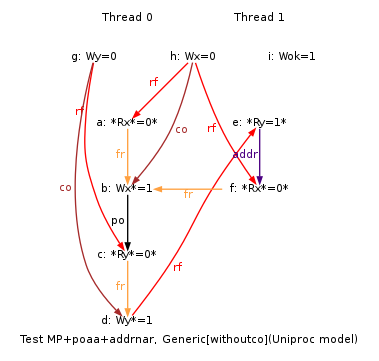

Test MP+poaa+addrnar
Executions for behaviour: "0:R0=0 ; 0:R1=0 ; 1:R0=1 ; 1:R2=0 ; ok=1 ; x=1 ; y=1"
ARM MP+poaa+addrnar
"PodWWAA RfeANa DpAddrdRNaR FreRA"
Cycle=RfeANa DpAddrdRNaR FreRA PodWWAA
Prefetch=0:x=F,0:y=W,1:y=F,1:x=T
Com=Rf Fr
Orig=PodWWAA RfeANa DpAddrdRNaR FreRA

 P0                  | P1             ;
 MOV %T3,#1          | LDR R0,[%y1]   ;
 LDREX R0,[%x0]      | EOR R1,R0,R0   ;
 STREX %T2,%T3,[%x0] | ADD %T1,R1,%x1 ;
 CMP %T2,#0          | LDREX R2,[%T1] ;
 BNE Fail0           |                ;
 MOV %T3,#1          |                ;
 LDREX R1,[%y0]      |                ;
 STREX %T2,%T3,[%y0] |                ;
 CMP %T2,#0          |                ;
 BNE Fail0           |                ;
 B Exit0             |                ;
 Fail0:              |                ;
 MOV R2,#0           |                ;
 STR R2,[%ok0]       |                ;
 Exit0:              |                ;
Observed
    0:R0=0; 0:R1=0; 1:R0=1; 1:R2=0; ok=1; x=1; y=1;
