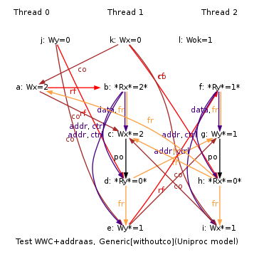

Test WWC+addraas
Executions for behaviour: "1:R0=2 ; 1:R2=0 ; 2:R0=1 ; 2:R2=0 ; ok=1 ; x=2 ; y=1"
ARM WWC+addraas
"RfeNaA DpAddrdWAA RfeAA DpAddrdWAA WseANa"
Cycle=RfeNaA DpAddrdWAA RfeAA DpAddrdWAA WseANa
Prefetch=1:x=F,1:y=W,2:y=F,2:x=W
Com=Rf Rf Ws
Orig=RfeNaA DpAddrdWAA RfeAA DpAddrdWAA WseANa

 P0           | P1                  | P2                  ;
 MOV R0,#2    | LDREX R0,[%x1]      | LDREX R0,[%y2]      ;
 STR R0,[%x0] | STREX %T2,R0,[%x1]  | STREX %T2,R0,[%y2]  ;
              | CMP %T2,#0          | CMP %T2,#0          ;
              | BNE Fail1           | BNE Fail2           ;
              | EOR R1,R0,R0        | EOR R1,R0,R0        ;
              | ADD %T1,R1,%y1      | ADD %T1,R1,%x2      ;
              | MOV %T3,#1          | MOV %T3,#1          ;
              | LDREX R2,[%T1]      | LDREX R2,[%T1]      ;
              | STREX %T2,%T3,[%T1] | STREX %T2,%T3,[%T1] ;
              | B Exit1             | B Exit2             ;
              | Fail1:              | Fail2:              ;
              | MOV R3,#0           | MOV R3,#0           ;
              | STR R3,[%ok1]       | STR R3,[%ok2]       ;
              | Exit1:              | Exit2:              ;
Observed
    1:R0=2; 1:R2=0; 2:R0=1; 2:R2=0; ok=1; x=2; y=1;
