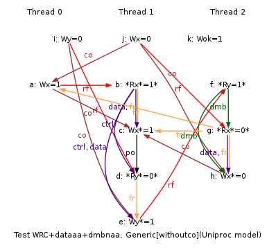

Test WRC+dataaa+dmbnaa
Executions for behaviour: "1:R0=1 ; 1:R2=0 ; 2:R0=1 ; 2:R1=0 ; ok=1 ; x=1 ; y=1"
ARM WRC+dataaa+dmbnaa
"RfeNaA DpDatadWAA RfeANa DMBdRRNaA FreANa"
Cycle=RfeNaA DpDatadWAA RfeANa DMBdRRNaA FreANa
Prefetch=1:x=F,1:y=W,2:y=F,2:x=T
Com=Rf Rf Fr
Orig=RfeNaA DpDatadWAA RfeANa DMBdRRNaA FreANa
{ ok=1;
%x0=x;
%x1=x; %y1=y; %ok1=ok;
%y2=y; %x2=x; %ok2=ok;
 P0           | P1                 | P2                 ;
 MOV R0,#1    | LDREX R0,[%x1]     | LDR R0,[%y2]       ;
 STR R0,[%x0] | STREX %T2,R0,[%x1] | DMB                ;
              | CMP %T2,#0         | LDREX R1,[%x2]     ;
              | BNE Fail1          | STREX %T2,R1,[%x2] ;
              | EOR R1,R0,R0       | CMP %T2,#0         ;
              | ADD R1,R1,#1       | BNE Fail2          ;
              | LDREX R2,[%y1]     | B Exit2            ;
              | STREX %T2,R1,[%y1] | Fail2:             ;
              | CMP %T2,#0         | MOV R2,#0          ;
              | BNE Fail1          | STR R2,[%ok2]      ;
              | B Exit1            | Exit2:             ;
              | Fail1:             |                    ;
              | MOV R3,#0          |                    ;
              | STR R3,[%ok1]      |                    ;
              | Exit1:             |                    ;
Observed
    1:R0=1; 1:R2=0; 2:R0=1; 2:R1=0; ok=1; x=1; y=1;
