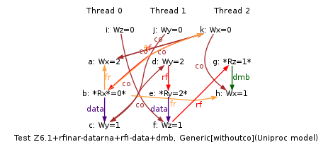

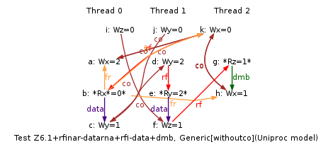

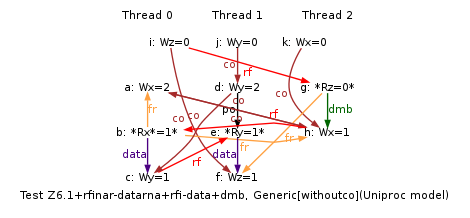

Test Z6.1+rfinar-datarna+rfi-data+dmb
Executions for behaviour: "0:R1=0 ; 1:R1=1 ; 2:R0=0 ; x=1 ; y=1"

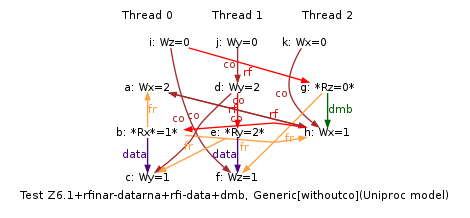

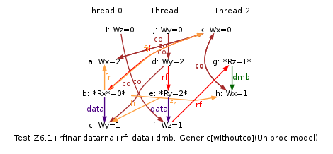

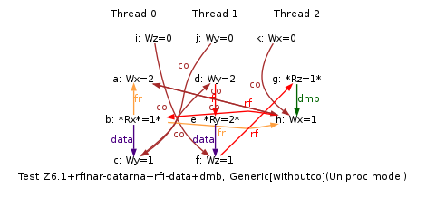

Executions for behaviour: "0:R1=0 ; 1:R1=2 ; 2:R0=0 ; x=1 ; y=1"

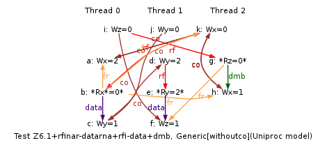

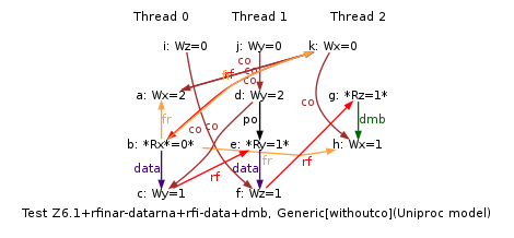

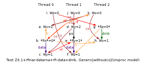

Executions for behaviour: "0:R1=0 ; 1:R1=1 ; 2:R0=1 ; x=1 ; y=1"

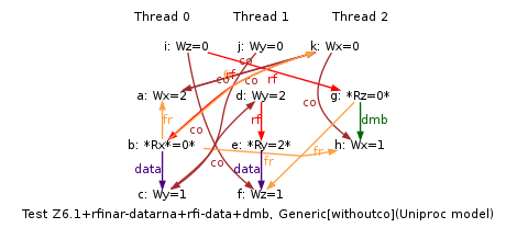

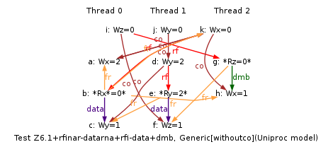

Executions for behaviour: "0:R1=0 ; 1:R1=2 ; 2:R0=1 ; x=1 ; y=1"

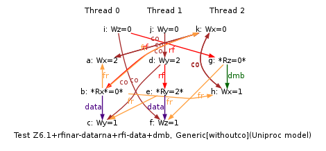

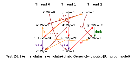

Executions for behaviour: "0:R1=0 ; 1:R1=1 ; 2:R0=0 ; x=2 ; y=1"

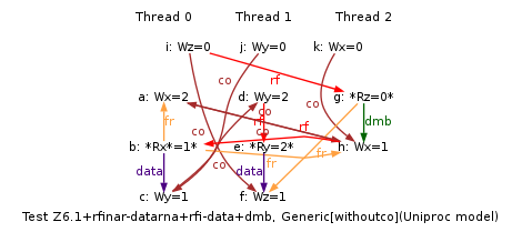

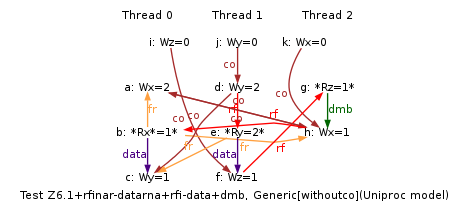

Executions for behaviour: "0:R1=1 ; 1:R1=1 ; 2:R0=0 ; x=2 ; y=1"

ARM Z6.1+rfinar-datarna+rfi-data+dmb
"RfiNaR DpDatadWRNa Wse Rfi DpDatadW Rfe DMBdRW Wse"
Cycle=Rfi DpDatadW Rfe DMBdRW Wse RfiNaR DpDatadWRNa Wse
Prefetch=0:x=F,0:y=W,1:y=F,1:z=W,2:z=F,2:x=W
Com=Ws Rf Ws
Orig=RfiNaR DpDatadWRNa Wse Rfi DpDatadW Rfe DMBdRW Wse
%x0=x; %y0=y;
%y1=y; %z1=z;
%z2=z; %x2=x;
 P0             | P1           | P2           ;
 MOV R0,#2      | MOV R0,#2    | LDR R0,[%z2] ;
 STR R0,[%x0]   | STR R0,[%y1] | DMB          ;
 LDREX R1,[%x0] | LDR R1,[%y1] | MOV R1,#1    ;
 EOR R2,R1,R1   | EOR R2,R1,R1 | STR R1,[%x2] ;
 ADD R2,R2,#1   | ADD R2,R2,#1 |              ;
 STR R2,[%y0]   | STR R2,[%z1] |              ;
    0:R1=0; 1:R1=1; 2:R0=0; x=1; y=1;
and 0:R1=0; 1:R1=2; 2:R0=0; x=1; y=1;
and 0:R1=0; 1:R1=1; 2:R0=1; x=1; y=1;
and 0:R1=0; 1:R1=2; 2:R0=1; x=1; y=1;
and 0:R1=0; 1:R1=1; 2:R0=0; x=2; y=1;
and 0:R1=1; 1:R1=1; 2:R0=0; x=2; y=1;
and 0:R1=0; 1:R1=2; 2:R0=0; x=2; y=1;
and 0:R1=1; 1:R1=2; 2:R0=0; x=2; y=1;
and 0:R1=0; 1:R1=1; 2:R0=1; x=2; y=1;
and 0:R1=0; 1:R1=2; 2:R0=1; x=2; y=1;
and 0:R1=1; 1:R1=2; 2:R0=1; x=2; y=1;
and 0:R1=0; 1:R1=2; 2:R0=0; x=1; y=2;
and 0:R1=0; 1:R1=2; 2:R0=1; x=1; y=2;
and 0:R1=0; 1:R1=2; 2:R0=0; x=2; y=2;
and 0:R1=1; 1:R1=2; 2:R0=0; x=2; y=2;
and 0:R1=0; 1:R1=2; 2:R0=1; x=2; y=2;
and 0:R1=1; 1:R1=2; 2:R0=1; x=2; y=2;
