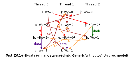

Test Z6.1+rfi-data+rfinar-datarna+dmb

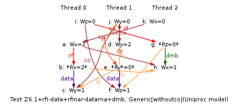

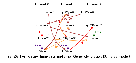

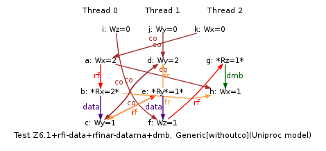

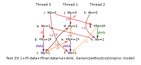

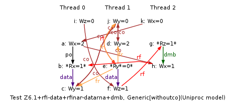

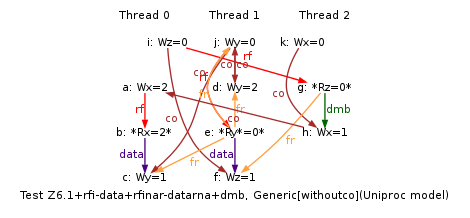

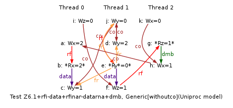

Executions for behaviour: "0:R1=1 ; 1:R1=0 ; 2:R0=0 ; x=1 ; y=1"

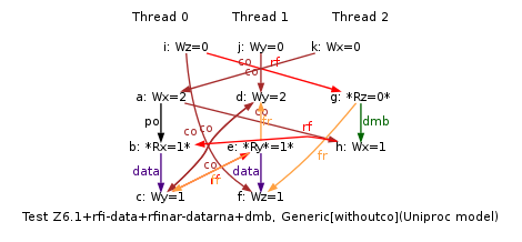

Executions for behaviour: "0:R1=2 ; 1:R1=0 ; 2:R0=0 ; x=1 ; y=1"

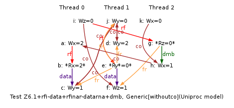

Executions for behaviour: "0:R1=1 ; 1:R1=0 ; 2:R0=1 ; x=1 ; y=1"

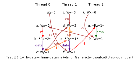

Executions for behaviour: "0:R1=2 ; 1:R1=0 ; 2:R0=1 ; x=1 ; y=1"

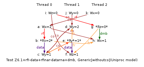

Executions for behaviour: "0:R1=2 ; 1:R1=0 ; 2:R0=0 ; x=2 ; y=1"

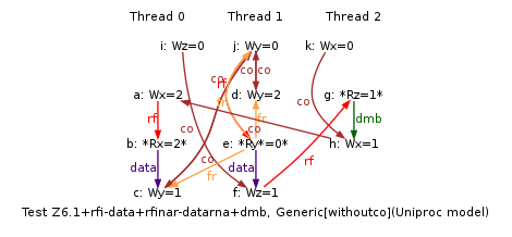

Executions for behaviour: "0:R1=2 ; 1:R1=0 ; 2:R0=1 ; x=2 ; y=1"
Executions for behaviour: "0:R1=1 ; 1:R1=0 ; 2:R0=0 ; x=1 ; y=2"
Executions for behaviour: "0:R1=2 ; 1:R1=0 ; 2:R0=0 ; x=1 ; y=2"
Executions for behaviour: "0:R1=1 ; 1:R1=1 ; 2:R0=0 ; x=1 ; y=2"
Executions for behaviour: "0:R1=2 ; 1:R1=1 ; 2:R0=0 ; x=1 ; y=2"
Executions for behaviour: "0:R1=1 ; 1:R1=0 ; 2:R0=1 ; x=1 ; y=2"
Executions for behaviour: "0:R1=2 ; 1:R1=0 ; 2:R0=1 ; x=1 ; y=2"
Executions for behaviour: "0:R1=2 ; 1:R1=1 ; 2:R0=1 ; x=1 ; y=2"
Executions for behaviour: "0:R1=2 ; 1:R1=0 ; 2:R0=0 ; x=2 ; y=2"
Executions for behaviour: "0:R1=2 ; 1:R1=1 ; 2:R0=0 ; x=2 ; y=2"
Executions for behaviour: "0:R1=2 ; 1:R1=0 ; 2:R0=1 ; x=2 ; y=2"
Executions for behaviour: "0:R1=2 ; 1:R1=1 ; 2:R0=1 ; x=2 ; y=2"
ARM Z6.1+rfi-data+rfinar-datarna+dmb
"Rfi DpDatadW Wse RfiNaR DpDatadWRNa Rfe DMBdRW Wse"
Cycle=Rfi DpDatadW Wse RfiNaR DpDatadWRNa Rfe DMBdRW Wse
Prefetch=0:x=F,0:y=W,1:y=F,1:z=W,2:z=F,2:x=W
Com=Ws Rf Ws
Orig=Rfi DpDatadW Wse RfiNaR DpDatadWRNa Rfe DMBdRW Wse
%x0=x; %y0=y;
%y1=y; %z1=z;
%z2=z; %x2=x;
 P0           | P1             | P2           ;
 MOV R0,#2    | MOV R0,#2      | LDR R0,[%z2] ;
 STR R0,[%x0] | STR R0,[%y1]   | DMB          ;
 LDR R1,[%x0] | LDREX R1,[%y1] | MOV R1,#1    ;
 EOR R2,R1,R1 | EOR R2,R1,R1   | STR R1,[%x2] ;
 ADD R2,R2,#1 | ADD R2,R2,#1   |              ;
 STR R2,[%y0] | STR R2,[%z1]   |              ;
    0:R1=1; 1:R1=0; 2:R0=0; x=1; y=1;
and 0:R1=2; 1:R1=0; 2:R0=0; x=1; y=1;
and 0:R1=1; 1:R1=0; 2:R0=1; x=1; y=1;
and 0:R1=2; 1:R1=0; 2:R0=1; x=1; y=1;
and 0:R1=2; 1:R1=0; 2:R0=0; x=2; y=1;
and 0:R1=2; 1:R1=0; 2:R0=1; x=2; y=1;
and 0:R1=1; 1:R1=0; 2:R0=0; x=1; y=2;
and 0:R1=2; 1:R1=0; 2:R0=0; x=1; y=2;
and 0:R1=1; 1:R1=1; 2:R0=0; x=1; y=2;
and 0:R1=2; 1:R1=1; 2:R0=0; x=1; y=2;
and 0:R1=1; 1:R1=0; 2:R0=1; x=1; y=2;
and 0:R1=2; 1:R1=0; 2:R0=1; x=1; y=2;
and 0:R1=2; 1:R1=1; 2:R0=1; x=1; y=2;
and 0:R1=2; 1:R1=0; 2:R0=0; x=2; y=2;
and 0:R1=2; 1:R1=1; 2:R0=0; x=2; y=2;
and 0:R1=2; 1:R1=0; 2:R0=1; x=2; y=2;
and 0:R1=2; 1:R1=1; 2:R0=1; x=2; y=2;
