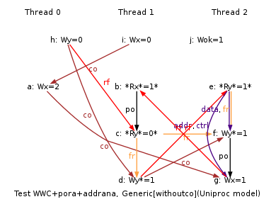

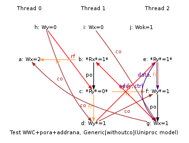

Test WWC+pora+addrana
Executions for behaviour: "1:R0=1 ; 1:R1=0 ; 2:R0=1 ; ok=1 ; x=1 ; y=1"
Executions for behaviour: "1:R0=1 ; 1:R1=0 ; 2:R0=1 ; ok=1 ; x=2 ; y=1"
ARM WWC+pora+addrana
"RfeNaR PodRWRA RfeAA DpAddrdWANa Wse"
Cycle=RfeNaR PodRWRA RfeAA DpAddrdWANa Wse
Prefetch=1:x=F,1:y=W,2:y=F,2:x=W
Com=Rf Rf Ws
Orig=RfeNaR PodRWRA RfeAA DpAddrdWANa Wse
{ ok=1;
%x0=x;
%x1=x; %y1=y; %ok1=ok;
%y2=y; %x2=x; %ok2=ok;
 P0           | P1                  | P2                 ;
 MOV R0,#2    | LDREX R0,[%x1]      | LDREX R0,[%y2]     ;
 STR R0,[%x0] | MOV %T3,#1          | STREX %T2,R0,[%y2] ;
              | LDREX R1,[%y1]      | CMP %T2,#0         ;
              | STREX %T2,%T3,[%y1] | BNE Fail2          ;
              | CMP %T2,#0          | EOR R1,R0,R0       ;
              | BNE Fail1           | MOV R2,#1          ;
              | B Exit1             | STR R2,[R1,%x2]    ;
              | Fail1:              | B Exit2            ;
              | MOV R2,#0           | Fail2:             ;
              | STR R2,[%ok1]       | MOV R3,#0          ;
              | Exit1:              | STR R3,[%ok2]      ;
              |                     | Exit2:             ;
Observed
    1:R0=1; 1:R1=0; 2:R0=1; ok=1; x=1; y=1;
and 1:R0=1; 1:R1=0; 2:R0=1; ok=1; x=2; y=1;
