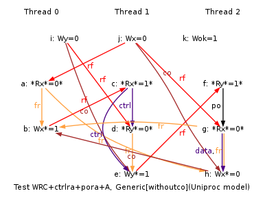

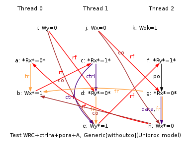

Test WRC+ctrlra+pora+A
Executions for behaviour: "0:R0=0 ; 1:R0=1 ; 1:R1=0 ; 2:R0=1 ; 2:R1=0 ; ok=1 ; x=1 ; y=1"
ARM WRC+ctrlra+pora+A
"RfeAR DpCtrldWRA RfeAR PodRRRA FreAA"
Cycle=RfeAR PodRRRA FreAA RfeAR DpCtrldWRA
Prefetch=1:x=F,1:y=W,2:y=F,2:x=T
Com=Rf Rf Fr
Orig=RfeAR DpCtrldWRA RfeAR PodRRRA FreAA
{ ok=1;
%x0=x; %ok0=ok;
%x1=x; %y1=y; %ok1=ok;
%y2=y; %x2=x; %ok2=ok;
 P0                  | P1                  | P2                 ;
 MOV %T3,#1          | LDREX R0,[%x1]      | LDREX R0,[%y2]     ;
 LDREX R0,[%x0]      | CMP R0,R0           | LDREX R1,[%x2]     ;
 STREX %T2,%T3,[%x0] | BNE LC00            | STREX %T2,R1,[%x2] ;
 CMP %T2,#0          | LC00:               | CMP %T2,#0         ;
 BNE Fail0           | MOV %T3,#1          | BNE Fail2          ;
 B Exit0             | LDREX R1,[%y1]      | B Exit2            ;
 Fail0:              | STREX %T2,%T3,[%y1] | Fail2:             ;
 MOV R1,#0           | CMP %T2,#0          | MOV R2,#0          ;
 STR R1,[%ok0]       | BNE Fail1           | STR R2,[%ok2]      ;
 Exit0:              | B Exit1             | Exit2:             ;
                     | Fail1:              |                    ;
                     | MOV R2,#0           |                    ;
                     | STR R2,[%ok1]       |                    ;
                     | Exit1:              |                    ;
Observed
    0:R0=0; 1:R0=1; 1:R1=0; 2:R0=1; 2:R1=0; ok=1; x=1; y=1;
