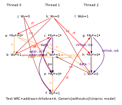

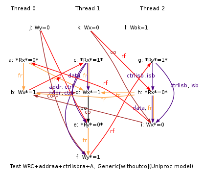

Test WRC+addraa+ctrlisbra+A
Executions for behaviour: "0:R0=0 ; 1:R0=1 ; 1:R2=0 ; 2:R0=1 ; 2:R1=0 ; ok=1 ; x=1 ; y=1"
ARM WRC+addraa+ctrlisbra+A
"RfeAA DpAddrdWAA RfeAR DpCtrlIsbdRRA FreAA"
Cycle=RfeAA DpAddrdWAA RfeAR DpCtrlIsbdRRA FreAA
Prefetch=1:x=F,1:y=W,2:y=F,2:x=T
Com=Rf Rf Fr
Orig=RfeAA DpAddrdWAA RfeAR DpCtrlIsbdRRA FreAA
