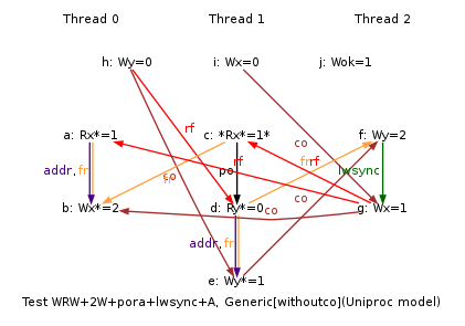

Executions for behaviour: "1:r1=1 ; ok=1 ; x=1 ; y=2"

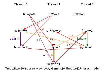

Executions for behaviour: "1:r1=1 ; ok=1 ; x=2 ; y=2"

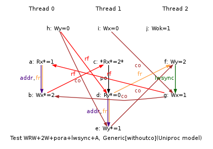

Executions for behaviour: "1:r1=2 ; ok=1 ; x=2 ; y=2"
