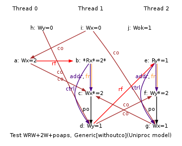

Test WRW+2W+poaps
Executions for behaviour: "1:r1=2 ; ok=1 ; x=2 ; y=2"
PPC WRW+2W+poaps
"RfePA PodRWAP WsePA PodWWAP Wse"
Cycle=RfePA PodRWAP WsePA PodWWAP Wse
Prefetch=0:x=F,1:y=W,2:y=F,2:x=W
Com=Rf Ws Ws
Orig=RfePA PodRWAP WsePA PodWWAP Wse
{ ok=1;
0:r2=x;
1:r2=x; 1:r4=y; 1:r6=ok;
2:r2=y; 2:r4=x; 2:r6=ok;
 P0           | P1              | P2               ;
 li r1,2      | lwarx r1,r0,r2  | li r1,2          ;
 stw r1,0(r2) | stwcx. r1,r0,r2 | lwarx %sta,r0,r2 ;
              | bne  Fail1      | stwcx. r1,r0,r2  ;
              | li r3,1         | bne  Fail2       ;
              | stw r3,0(r4)    | li r3,1          ;
              | b   Exit1       | stw r3,0(r4)     ;
              | Fail1:          | b   Exit2        ;
              | li r5,0         | Fail2:           ;
              | stw r5,0(r6)    | li r5,0          ;
              | Exit1:          | stw r5,0(r6)     ;
              |                 | Exit2:           ;
Observed
    1:r1=2; ok=1; x=2; y=2;
