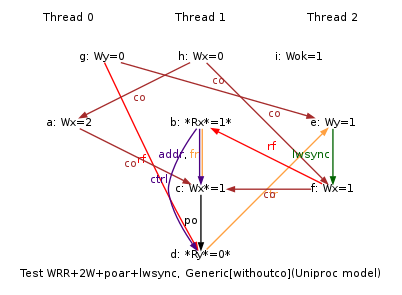

Test WRR+2W+poar+lwsync
Executions for behaviour: "1:r1=1 ; 1:r3=0 ; ok=1 ; x=1"
Executions for behaviour: "1:r1=1 ; 1:r3=0 ; ok=1 ; x=2"
PPC WRR+2W+poar+lwsync
"RfePA PodRRAR FreRP LwSyncdWW Wse"
Cycle=RfePA PodRRAR FreRP LwSyncdWW Wse
Prefetch=0:x=F,1:y=T,2:x=W
Com=Rf Fr Ws
Orig=RfePA PodRRAR FreRP LwSyncdWW Wse
{ ok=1;
0:r2=x;
1:r2=x; 1:r4=y; 1:r6=ok;
2:r2=y; 2:r4=x;
 P0           | P1              | P2           ;
 li r1,2      | lwarx r1,r0,r2  | li r1,1      ;
 stw r1,0(r2) | stwcx. r1,r0,r2 | stw r1,0(r2) ;
              | bne  Fail1      | lwsync       ;
              | lwarx r3,r0,r4  | li r3,1      ;
              | b   Exit1       | stw r3,0(r4) ;
              | Fail1:          |              ;
              | li r5,0         |              ;
              | stw r5,0(r6)    |              ;
              | Exit1:          |              ;
Observed
    1:r1=1; 1:r3=0; ok=1; x=1;
and 1:r1=1; 1:r3=0; ok=1; x=2;
