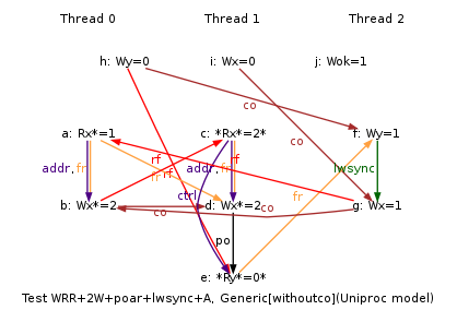

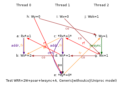

Test WRR+2W+poar+lwsync+A
Executions for behaviour: "1:r1=1 ; 1:r3=0 ; ok=1 ; x=1"
Executions for behaviour: "1:r1=1 ; 1:r3=0 ; ok=1 ; x=2"
Executions for behaviour: "1:r1=2 ; 1:r3=0 ; ok=1 ; x=2"
PPC WRR+2W+poar+lwsync+A
"RfeAA PodRRAR FreRP LwSyncdWW WsePA"
Cycle=RfeAA PodRRAR FreRP LwSyncdWW WsePA
Prefetch=0:x=F,1:y=T,2:x=W
Com=Rf Fr Ws
Orig=RfeAA PodRRAR FreRP LwSyncdWW WsePA
{ ok=1;
0:r2=x; 0:r4=ok;
1:r2=x; 1:r4=y; 1:r6=ok;
2:r2=y; 2:r4=x;
 P0               | P1              | P2           ;
 li r1,2          | lwarx r1,r0,r2  | li r1,1      ;
 lwarx %sta,r0,r2 | stwcx. r1,r0,r2 | stw r1,0(r2) ;
 stwcx. r1,r0,r2  | bne  Fail1      | lwsync       ;
 bne  Fail0       | lwarx r3,r0,r4  | li r3,1      ;
 b   Exit0        | b   Exit1       | stw r3,0(r4) ;
 Fail0:           | Fail1:          |              ;
 li r3,0          | li r5,0         |              ;
 stw r3,0(r4)     | stw r5,0(r6)    |              ;
 Exit0:           | Exit1:          |              ;
Observed
    1:r1=1; 1:r3=0; ok=1; x=1;
and 1:r1=1; 1:r3=0; ok=1; x=2;
and 1:r1=2; 1:r3=0; ok=1; x=2;
