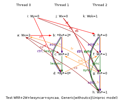

Test WRR+2W+lwsyncar+syncaa
Executions for behaviour: "1:r1=2 ; 1:r3=0 ; ok=1 ; x=2"
PPC WRR+2W+lwsyncar+syncaa
"RfePA LwSyncdRRAR FreRA SyncdWWAA WseAP"
Cycle=RfePA LwSyncdRRAR FreRA SyncdWWAA WseAP
Prefetch=0:x=F,1:y=T,2:x=W
Com=Rf Fr Ws
Orig=RfePA LwSyncdRRAR FreRA SyncdWWAA WseAP
{ ok=1;
0:r2=x;
1:r2=x; 1:r4=y; 1:r6=ok;
2:r2=y; 2:r4=x; 2:r6=ok;
 P0           | P1              | P2               ;
 li r1,2      | lwarx r1,r0,r2  | li r1,1          ;
 stw r1,0(r2) | stwcx. r1,r0,r2 | lwarx %sta,r0,r2 ;
              | bne  Fail1      | stwcx. r1,r0,r2  ;
              | lwsync          | bne  Fail2       ;
              | lwarx r3,r0,r4  | sync             ;
              | b   Exit1       | li r3,1          ;
              | Fail1:          | lwarx %sta,r0,r4 ;
              | li r5,0         | stwcx. r3,r0,r4  ;
              | stw r5,0(r6)    | bne  Fail2       ;
              | Exit1:          | b   Exit2        ;
              |                 | Fail2:           ;
              |                 | li r5,0          ;
              |                 | stw r5,0(r6)     ;
              |                 | Exit2:           ;
Observed
    1:r1=2; 1:r3=0; ok=1; x=2;
