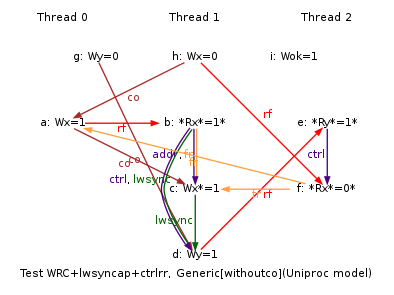

Test WRC+lwsyncap+ctrlrr
Executions for behaviour: "1:r1=1 ; 2:r1=1 ; 2:r3=0 ; ok=1"
PPC WRC+lwsyncap+ctrlrr
"RfePA LwSyncdRWAP RfePR DpCtrldRRR FreRP"
Cycle=RfePA LwSyncdRWAP RfePR DpCtrldRRR FreRP
Prefetch=0:x=T,2:x=T
Com=Rf Rf Fr
Orig=RfePA LwSyncdRWAP RfePR DpCtrldRRR FreRP
{ ok=1;
0:r2=x;
1:r2=x; 1:r4=y; 1:r6=ok;
2:r2=y; 2:r4=x;
 P0           | P1              | P2             ;
 li r1,1      | lwarx r1,r0,r2  | lwarx r1,r0,r2 ;
 stw r1,0(r2) | stwcx. r1,r0,r2 | cmpw r1,r1     ;
              | bne  Fail1      | beq  LC00      ;
              | lwsync          | LC00:          ;
              | li r3,1         | lwarx r3,r0,r4 ;
              | stw r3,0(r4)    |                ;
              | b   Exit1       |                ;
              | Fail1:          |                ;
              | li r5,0         |                ;
              | stw r5,0(r6)    |                ;
              | Exit1:          |                ;
Observed
    1:r1=1; 2:r1=1; 2:r3=0; ok=1;
