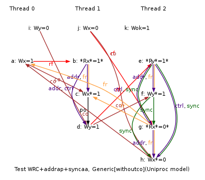

Test WRC+addrap+syncaa
Executions for behaviour: "1:r1=1 ; 2:r1=1 ; 2:r3=0 ; ok=1"
PPC WRC+addrap+syncaa
"RfePA DpAddrdWAP RfePA SyncdRRAA FreAP"
Cycle=RfePA SyncdRRAA FreAP RfePA DpAddrdWAP
Prefetch=0:x=T,2:x=T
Com=Rf Rf Fr
Orig=RfePA DpAddrdWAP RfePA SyncdRRAA FreAP
{ ok=1;
0:r2=x;
1:r2=x; 1:r5=y; 1:r7=ok;
2:r2=y; 2:r4=x; 2:r6=ok;
 P0           | P1              | P2              ;
 li r1,1      | lwarx r1,r0,r2  | lwarx r1,r0,r2  ;
 stw r1,0(r2) | stwcx. r1,r0,r2 | stwcx. r1,r0,r2 ;
              | bne  Fail1      | bne  Fail2      ;
              | xor r3,r1,r1    | sync            ;
              | li r4,1         | lwarx r3,r0,r4  ;
              | stwx r4,r3,r5   | stwcx. r3,r0,r4 ;
              | b   Exit1       | bne  Fail2      ;
              | Fail1:          | b   Exit2       ;
              | li r6,0         | Fail2:          ;
              | stw r6,0(r7)    | li r5,0         ;
              | Exit1:          | stw r5,0(r6)    ;
              |                 | Exit2:          ;
Observed
    1:r1=1; 2:r1=1; 2:r3=0; ok=1;
