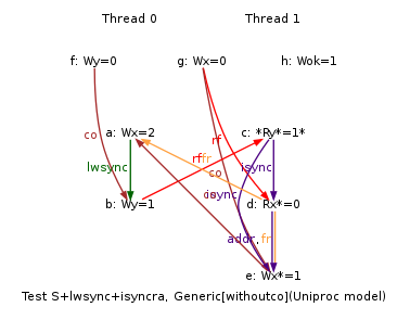

Test S+lwsync+isyncra
Executions for behaviour: "1:r1=1 ; ok=1 ; x=2"
PPC S+lwsync+isyncra
"LwSyncdWW RfePR ISyncdRWRA WseAP"
Cycle=RfePR ISyncdRWRA WseAP LwSyncdWW
Prefetch=0:x=F,1:x=W
Com=Rf Ws
Orig=LwSyncdWW RfePR ISyncdRWRA WseAP
{ ok=1;
0:r2=x; 0:r4=y;
1:r2=y; 1:r4=x; 1:r6=ok;
 P0           | P1               ;
 li r1,2      | lwarx r1,r0,r2   ;
 stw r1,0(r2) | isync            ;
 lwsync       | li r3,1          ;
 li r3,1      | lwarx %sta,r0,r4 ;
 stw r3,0(r4) | stwcx. r3,r0,r4  ;
              | bne  Fail1       ;
              | b   Exit1        ;
              | Fail1:           ;
              | li r5,0          ;
              | stw r5,0(r6)     ;
              | Exit1:           ;
Observed
    1:r1=1; ok=1; x=2;
