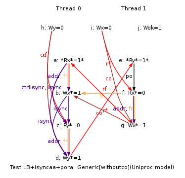

Test LB+isyncaa+pora
Executions for behaviour: "0:r1=1 ; 1:r1=1 ; ok=1"
PPC LB+isyncaa+pora
"ISyncdRWAA RfeAR PodRWRA RfeAA"
Cycle=RfeAA ISyncdRWAA RfeAR PodRWRA
Prefetch=
Com=Rf Rf
Orig=ISyncdRWAA RfeAR PodRWRA RfeAA

 P0               | P1               ;
 lwarx r1,r0,r2   | lwarx r1,r0,r2   ;
 stwcx. r1,r0,r2  | li r3,1          ;
 bne  Fail0       | lwarx %sta,r0,r4 ;
 isync            | stwcx. r3,r0,r4  ;
 li r3,1          | bne  Fail1       ;
 lwarx %sta,r0,r4 | b   Exit1        ;
 stwcx. r3,r0,r4  | Fail1:           ;
 bne  Fail0       | li r5,0          ;
 b   Exit0        | stw r5,0(r6)     ;
 Fail0:           | Exit1:           ;
 li r5,0          |                  ;
 stw r5,0(r6)     |                  ;
 Exit0:           |                  ;
Observed
    0:r1=1; 1:r1=1; ok=1;
