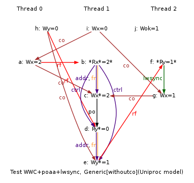

Test WWC+poaa+lwsync
Executions for behaviour: "1:r1=2 ; 2:r1=1 ; ok=1 ; x=2"
PPC WWC+poaa+lwsync
"RfePA PodRWAA RfeAP LwSyncdRW Wse"
Cycle=RfeAP LwSyncdRW Wse RfePA PodRWAA
Prefetch=0:x=F,2:x=W
Com=Rf Rf Ws
Orig=RfePA PodRWAA RfeAP LwSyncdRW Wse
{ ok=1;
0:r2=x;
1:r2=x; 1:r4=y; 1:r6=ok;
2:r2=y; 2:r4=x;
 P0           | P1               | P2           ;
 li r1,2      | lwarx r1,r0,r2   | lwz r1,0(r2) ;
 stw r1,0(r2) | stwcx. r1,r0,r2  | lwsync       ;
              | bne  Fail1       | li r3,1      ;
              | li r3,1          | stw r3,0(r4) ;
              | lwarx %sta,r0,r4 |              ;
              | stwcx. r3,r0,r4  |              ;
              | bne  Fail1       |              ;
              | b   Exit1        |              ;
              | Fail1:           |              ;
              | li r5,0          |              ;
              | stw r5,0(r6)     |              ;
              | Exit1:           |              ;
Observed
    1:r1=2; 2:r1=1; ok=1; x=2;
