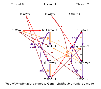

Test WRW+WR+addraa+poaa
Executions for behaviour: "1:r1=1 ; 2:r3=0 ; ok=1 ; y=2"
PPC WRW+WR+addraa+poaa
"RfePA DpAddrdWAA WseAA PodWRAA FreAP"
Cycle=RfePA DpAddrdWAA WseAA PodWRAA FreAP
Prefetch=0:x=T,1:y=W,2:y=F,2:x=T
Com=Rf Ws Fr
Orig=RfePA DpAddrdWAA WseAA PodWRAA FreAP
{ ok=1;
0:r2=x;
1:r2=x; 1:r5=y; 1:r7=ok;
2:r2=y; 2:r4=x; 2:r6=ok;
 P0           | P1               | P2               ;
 li r1,1      | lwarx r1,r0,r2   | li r1,2          ;
 stw r1,0(r2) | stwcx. r1,r0,r2  | lwarx %sta,r0,r2 ;
              | bne  Fail1       | stwcx. r1,r0,r2  ;
              | xor r3,r1,r1     | bne  Fail2       ;
              | li r4,1          | lwarx r3,r0,r4   ;
              | lwarx %sta,r3,r5 | stwcx. r3,r0,r4  ;
              | stwcx. r4,r3,r5  | bne  Fail2       ;
              | bne  Fail1       | b   Exit2        ;
              | b   Exit1        | Fail2:           ;
              | Fail1:           | li r5,0          ;
              | li r6,0          | stw r5,0(r6)     ;
              | stw r6,0(r7)     | Exit2:           ;
              | Exit1:           |                  ;
Observed
    1:r1=1; 2:r3=0; ok=1; y=2;
