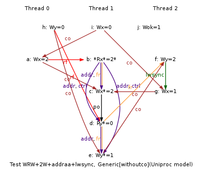

Test WRW+2W+addraa+lwsync
Executions for behaviour: "1:r1=2 ; ok=1 ; x=2 ; y=2"
PPC WRW+2W+addraa+lwsync
"RfePA DpAddrdWAA WseAP LwSyncdWW Wse"
Cycle=RfePA DpAddrdWAA WseAP LwSyncdWW Wse
Prefetch=0:x=F,1:y=W,2:y=F,2:x=W
Com=Rf Ws Ws
Orig=RfePA DpAddrdWAA WseAP LwSyncdWW Wse
{ ok=1;
0:r2=x;
1:r2=x; 1:r5=y; 1:r7=ok;
2:r2=y; 2:r4=x;
 P0           | P1               | P2           ;
 li r1,2      | lwarx r1,r0,r2   | li r1,2      ;
 stw r1,0(r2) | stwcx. r1,r0,r2  | stw r1,0(r2) ;
              | bne  Fail1       | lwsync       ;
              | xor r3,r1,r1     | li r3,1      ;
              | li r4,1          | stw r3,0(r4) ;
              | lwarx %sta,r3,r5 |              ;
              | stwcx. r4,r3,r5  |              ;
              | bne  Fail1       |              ;
              | b   Exit1        |              ;
              | Fail1:           |              ;
              | li r6,0          |              ;
              | stw r6,0(r7)     |              ;
              | Exit1:           |              ;
Observed
    1:r1=2; ok=1; x=2; y=2;
