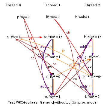

Test WRC+ctrlaas
Executions for behaviour: "1:r1=1 ; 2:r1=1 ; 2:r3=0 ; ok=1"
PPC WRC+ctrlaas
"RfePA DpCtrldWAA RfeAA DpCtrldRAA FreAP"
Cycle=RfeAA DpCtrldRAA FreAP RfePA DpCtrldWAA
Prefetch=0:x=T,2:x=T
Com=Rf Rf Fr
Orig=RfePA DpCtrldWAA RfeAA DpCtrldRAA FreAP
{ ok=1;
0:r2=x;
1:r2=x; 1:r4=y; 1:r6=ok;
2:r2=y; 2:r4=x; 2:r6=ok;
 P0           | P1               | P2              ;
 li r1,1      | lwarx r1,r0,r2   | lwarx r1,r0,r2  ;
 stw r1,0(r2) | stwcx. r1,r0,r2  | stwcx. r1,r0,r2 ;
              | bne  Fail1       | bne  Fail2      ;
              | cmpw r1,r1       | cmpw r1,r1      ;
              | beq  LC00        | beq  LC01       ;
              | LC00:            | LC01:           ;
              | li r3,1          | lwarx r3,r0,r4  ;
              | lwarx %sta,r0,r4 | stwcx. r3,r0,r4 ;
              | stwcx. r3,r0,r4  | bne  Fail2      ;
              | bne  Fail1       | b   Exit2       ;
              | b   Exit1        | Fail2:          ;
              | Fail1:           | li r5,0         ;
              | li r5,0          | stw r5,0(r6)    ;
              | stw r5,0(r6)     | Exit2:          ;
              | Exit1:           |                 ;
Observed
    1:r1=1; 2:r1=1; 2:r3=0; ok=1;
