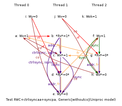

Test RWC+ctrlisyncaa+syncpa
Executions for behaviour: "1:r1=1 ; 1:r3=0 ; 2:r3=0 ; ok=1"
PPC RWC+ctrlisyncaa+syncpa
"RfePA DpCtrlIsyncdRAA FreAP SyncdWRPA FreAP"
Cycle=RfePA DpCtrlIsyncdRAA FreAP SyncdWRPA FreAP
Prefetch=0:x=T,1:y=T,2:x=T
Com=Rf Fr Fr
Orig=RfePA DpCtrlIsyncdRAA FreAP SyncdWRPA FreAP
{ ok=1;
0:r2=x;
1:r2=x; 1:r4=y; 1:r6=ok;
2:r2=y; 2:r4=x; 2:r6=ok;
 P0           | P1              | P2              ;
 li r1,1      | lwarx r1,r0,r2  | li r1,1         ;
 stw r1,0(r2) | stwcx. r1,r0,r2 | stw r1,0(r2)    ;
              | bne  Fail1      | sync            ;
              | cmpw r1,r1      | lwarx r3,r0,r4  ;
              | beq  LC00       | stwcx. r3,r0,r4 ;
              | LC00:           | bne  Fail2      ;
              | isync           | b   Exit2       ;
              | lwarx r3,r0,r4  | Fail2:          ;
              | stwcx. r3,r0,r4 | li r5,0         ;
              | bne  Fail1      | stw r5,0(r6)    ;
              | b   Exit1       | Exit2:          ;
              | Fail1:          |                 ;
              | li r5,0         |                 ;
              | stw r5,0(r6)    |                 ;
              | Exit1:          |                 ;
Observed
    1:r1=1; 1:r3=0; 2:r3=0; ok=1;
