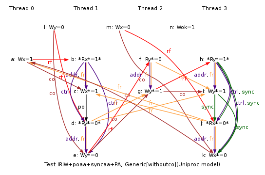

Test IRIW+poaa+syncaa+PA
Executions for behaviour: "1:r1=1 ; 1:r3=0 ; 3:r1=1 ; 3:r3=0 ; ok=1"
PPC IRIW+poaa+syncaa+PA
"RfePA PodRRAA FreAA RfeAA SyncdRRAA FreAP"
Cycle=RfeAA SyncdRRAA FreAP RfePA PodRRAA FreAA
Prefetch=0:x=T,1:y=T,2:y=T,3:x=T
Com=Rf Fr Rf Fr
Orig=RfePA PodRRAA FreAA RfeAA SyncdRRAA FreAP
