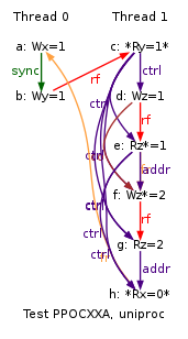

Test PPOCXXA
PPC PPOCXXA
"SyncdWW Rfe DpCtrldW PosWR Rmw PosWR DpAddrdR Fre"
Com=Rf Fr
{ ok=1;
0:r2=x; 0:r4=y;
1:r2=y; 1:r4=z; 1:r10=x; 1:r12=ok;
 P0           | P1              ;
 li r1,1      | lwz r1,0(r2)    ;
 stw r1,0(r2) | cmpw r1,r1      ;
 sync         | beq  LC00       ;
 li r3,1      | LC00:           ;
 stw r3,0(r4) | li r3,1         ;
              | stw r3,0(r4)    ;
              | lwarx r5,r0,r4  ;
              | li r6,2         ;
              | stwcx. r6,r0,r4 ;
              | bne  Fail1      ;
              | lwz r7,0(r4)    ;
              | xor r8,r7,r7    ;
              | lwzx r9,r8,r10  ;
              | b   Exit1       ;
              | Fail1:          ;
              | li r11,0        ;
              | stw r11,0(r12)  ;
              | Exit1:          ;
Observed
    1:r1=1; 1:r9=0; ok=1; z=2;
