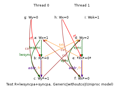

Test R+lwsyncpa+syncpa
Executions for behaviour: "1:r3=0 ; ok=1 ; y=2"
PPC R+lwsyncpa+syncpa
"LwSyncdWWPA WseAP SyncdWRPA FreAP"
Cycle=FreAP LwSyncdWWPA WseAP SyncdWRPA
Prefetch=0:y=W,1:y=F,1:x=T
Com=Ws Fr
Orig=LwSyncdWWPA WseAP SyncdWRPA FreAP
{ ok=1;
0:r2=x; 0:r4=y; 0:r6=ok;
1:r2=y; 1:r4=x; 1:r6=ok;
 P0               | P1              ;
 li r1,1          | li r1,2         ;
 stw r1,0(r2)     | stw r1,0(r2)    ;
 lwsync           | sync            ;
 li r3,1          | lwarx r3,r0,r4  ;
 lwarx %sta,r0,r4 | stwcx. r3,r0,r4 ;
 stwcx. r3,r0,r4  | bne  Fail1      ;
 bne  Fail0       | b   Exit1       ;
 b   Exit0        | Fail1:          ;
 Fail0:           | li r5,0         ;
 li r5,0          | stw r5,0(r6)    ;
 stw r5,0(r6)     | Exit1:          ;
 Exit0:           |                 ;
Observed
    1:r3=0; ok=1; y=2;
