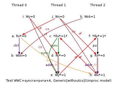

Test WWC+syncra+pora+A
Executions for behaviour: "1:r1=1 ; 2:r1=1 ; ok=0 ; x=1"
Executions for behaviour: "1:r1=1 ; 2:r1=1 ; ok=1 ; x=1"
Executions for behaviour: "1:r1=1 ; 2:r1=1 ; ok=1 ; x=2"
Executions for behaviour: "1:r1=2 ; 2:r1=1 ; ok=1 ; x=2"
